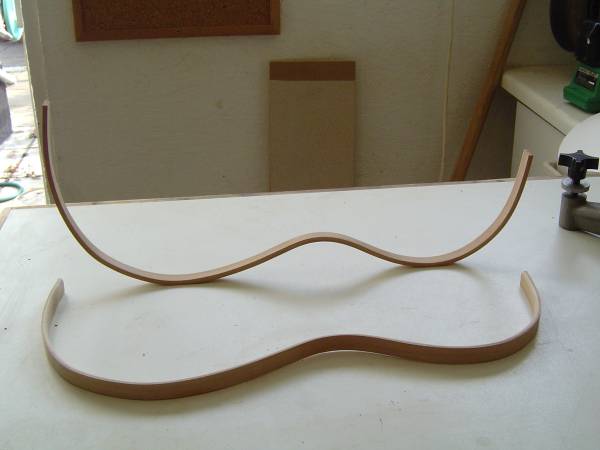

I have recently gone over to laminated solid linings and I believe they are a quantum leap (a quantum is actually a very small amnount but you get the picture) in building.

Colin, How wide do you make your laminated linings?

For classicals(Spanish school) I use laminated solid linings for the back.
I use dentellones for the top. For the dentellones I use alternating blocks of 10mm high by 8mm wide by 8mm deep and 8mm high by 8mm wide by 8mm deep, with the inner (front face) beveled so that the ledge at the top and bottom of the piece is 3mm. This is the style of Jose Romanillos and is typically Spanish. It allows the top to move freely with less wood mass around the top rim than a solid or kerfed lining.
Dentellones are sometimes mistakenly called tentellones but it is dente meaning of the tooth as in dentil moulding. It was years ago that an article on the classical guitar was written in which the author referred to the blocks as tentellones and the name has persisted but it is dentelonnes.
I really like a laminated solid lining for the back as it adds alot of rigidity and looks very clean and handmade where as kerfed linings no matter how nice they look always seem too manufactured.
Note that I am only speaking for classical guitars in the Spanish style and have used all of the other sorts of linings for other guitars in the past.

   Very nice linings. I would be tempted to use the bent sides propped in the mold as the form for laminating those linings. Is that how you do it? I can imagine that it really stiffens the sides.
PostPosted: Wed May 23, 2007 11:54 pm
Colin, I'd be interested in how you make such nice neat linings too. I can imagine bending six identical pieces at one time on the bender, then gluing them up in the mold. How does he do it?
